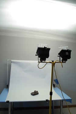

WEB EXTRA: Halogen work lights
Here's another improvisation just to get you thinking. I pulled out a set of 1,000-watt halogen work lamps from the storage room and aimed them at the model from a safe distance. Even with a two-unit setup, such high-intensity light without any diffusion created harsh shadows. Next I shone the lights on the white ceiling above the models. This is called reflective or bounce lighting and has the same effect as the diffuser. It spreads and softens the lighting.
I wouldn't recommend buying halogens specifically for model photography as they're too hot and clumsy, but if you already have something like this and only shoot your models a couple of times a year, you might be able to refine a solution.
