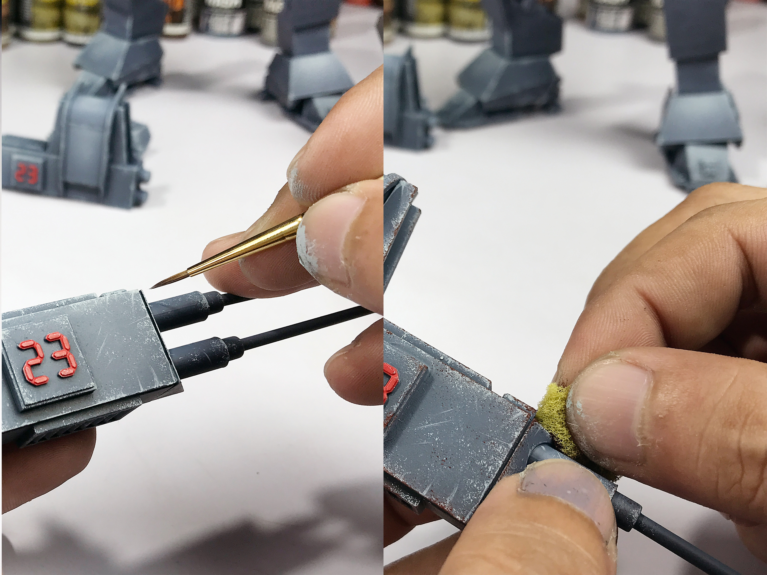

4. Chipped paint and scratches
Several techniques for chipping paint exist, but the simplest requires only a fine tipped brush and/or a micro-fiber sponge. Typically, a couple of coats of paint go onto full-size vehicles—at least a primer coat and then the color coat. Figure out the color of your vehicle’s primer coat (often a dark gray) and then paint tiny “chips” with your paintbrush in places that would naturally see wear. Try to make the chips appear random.
Alternatively, you can tear a small piece of a micro-fiber sponge, hold it with tweezers, dip it in the paint and blot away the excess (you don’t need a lot!), and then touch it to the model where you want to see paint chips. The sponge should naturally create a random pattern. However, be sure to twist your and adjust the angle between touching the sponge to the model to maximize the irregularities.
If you want to simulate deep gouges that go all the way to the metal, switch to a metallic color and use the same method and concentrate on the places you’ve already made paint chips.
This technique is easy to overdo, so be restrained the first few times and use a critical eye when assessing your work.
